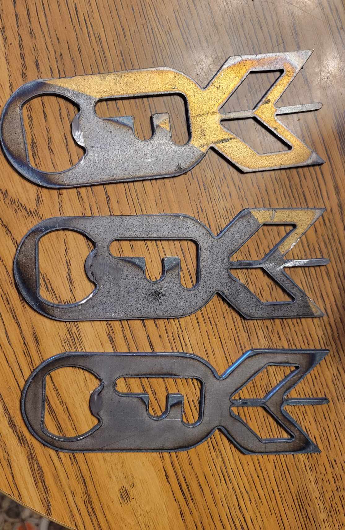

F bomb bottle opener
Simple small file used it to dial my machine in and used the finished cuts for Christmas gifts.

Looks great, but do I have to change inside cut and lead in in the arcdroid before cutting?
@Jarle If you are using the .dxf file you may need to go into Trace and flip the cut side on the inside fin cuts. Simply touch on the line you want to edit (it’ll turn bright red) and then hit the Edit button. Toggle the cut side around and you notice the yellow line (lead) will flip sides of the line.
