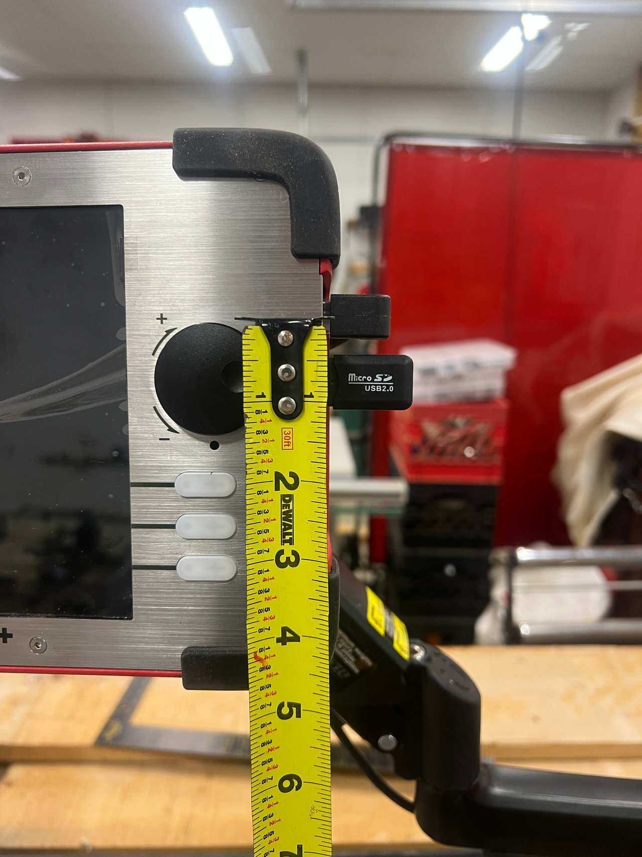

Can anyone provide the unit dimensions please.
Want to design a screen holder to 3d print.
LxWxH ?
Corner radius?
And exact where the 3 plugs on the side are?
Size and location of the large button/wheel?
Ordered mine a few days ago and waiting for delivery.
@Andrew ?? Please :grin:

I will start to draw a new box
The rear holes are tapped 5mm and appear to be some kind of standard.
Has anyone received the power supply upgrade yet?
VESA 100mm monitor-mount standard.
