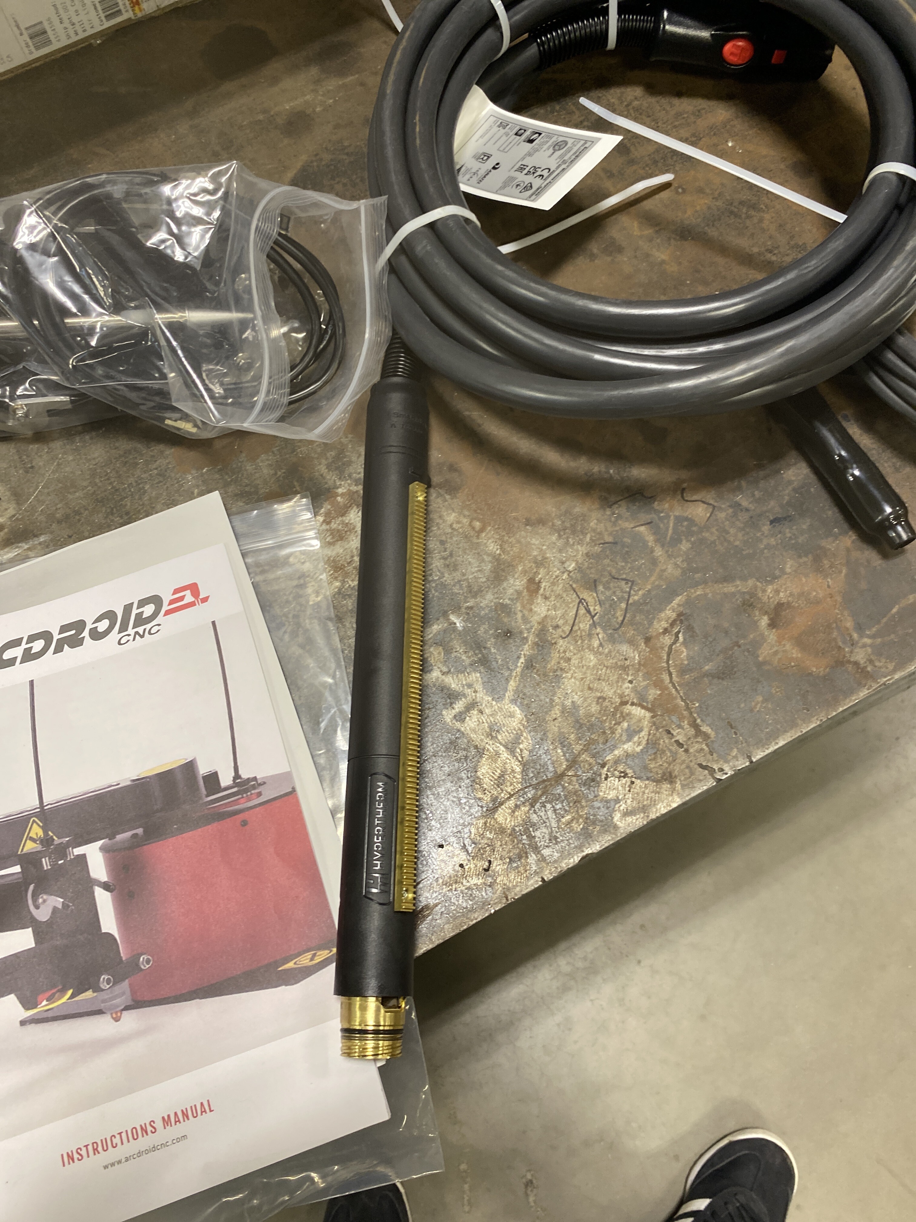

Hello everyone, I just bought an arcdroid CNC . I’m looking for some an advice. I have a track torch currently. Has anyone else used this style? It looks big and bulky.
Got pictures and what type of plasma cutter
Yep that’ll work but…
1st..remove the brass wrak and you’ll be able to clamp better.
Mounting things at the bottom basically means you have a big stick waving around above the head. this is no great for vibration. The solution is to Flip the torch mount over and clamp in the middle. this will give you a much more stable result
