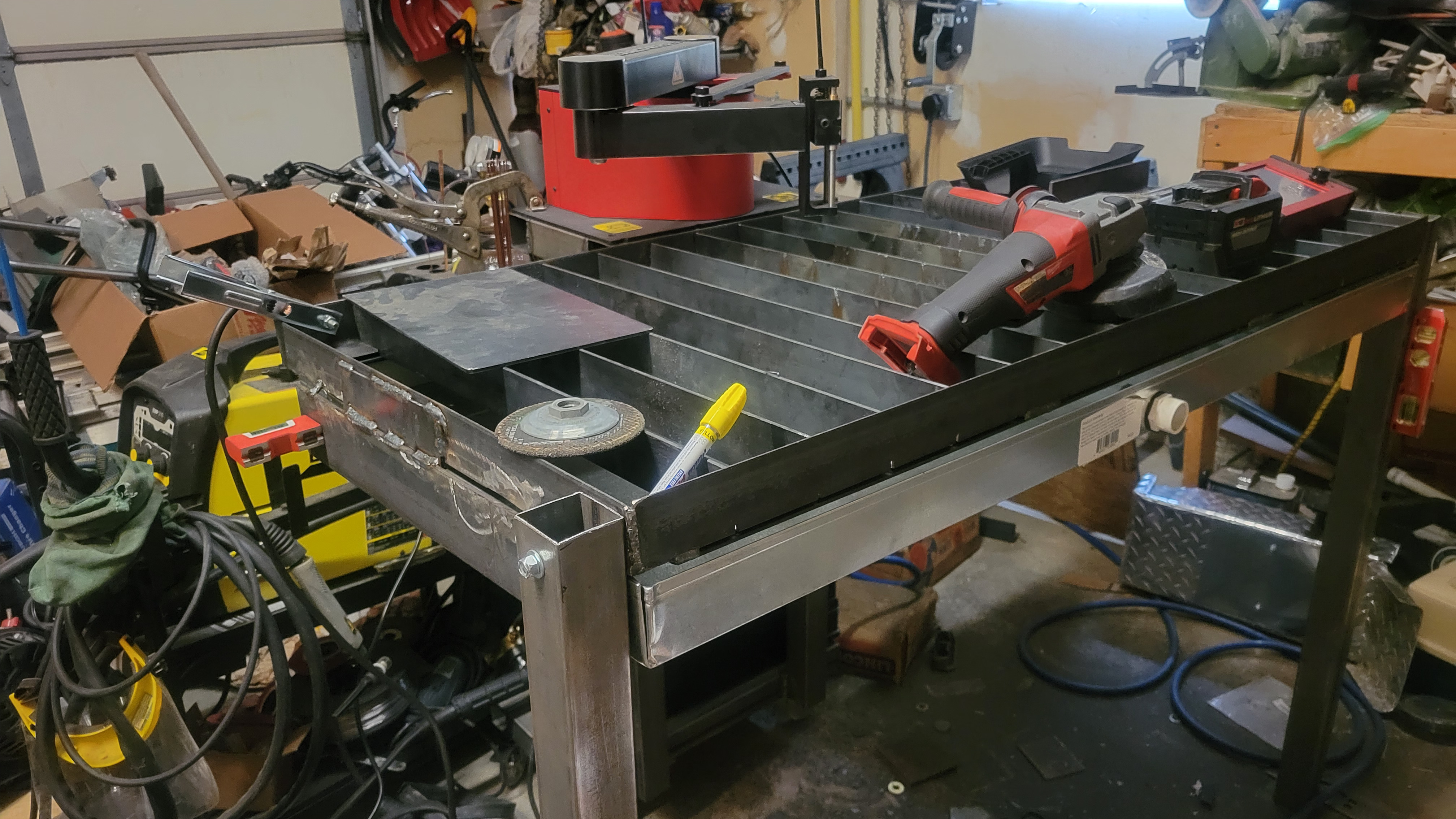

I have a water bed and just depends on how much water I have in the tray but I have found 3 or 4 inches works wonderfully. I haven’t filled my table all the way yet but it would be about 2" from the torch
Did you build your own table? Princess Auto has a table, but it doesn’t have a water tray…
Any water tray will catch a lot of debris, I only put an inch of water in mine so it’s probably 4-5 inches below the cut surface. Works well. To really reduce smoke the water has to be right up to your material. Not that lower water levels don’t reduce smoke some but to really minimize it, needs to be right up close to cutting surface. And I likely wouldn’t recommend it with the ArcDroid. It can’t take a whole lot of water splashing.
@BenA yes I built a table that folds up for storage. It hold about 15 gallons of water when completely full
I like the look of that. I was thinking to make it bolt to the wall at one end and fold down when not being used.

Ive made a couple flanges and other things from the droid. If you want more pictures of the table i can get you some.
