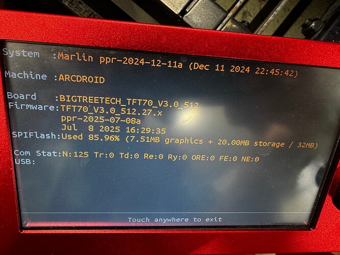

Are you sure you are on the most updated firmware? Go to settings, tap the arcdroid logo five times and then choose version info.
Post us a snap of what you see I’ll and I’ll have a better idea what might be going on
Your support confirmed I’m on the latest version. I sent videos of the unit doing this with a Fluke 289 connected in continuity mode where it triggers the torch regardless of the dry run setting. My plasma is completely disconnected.
