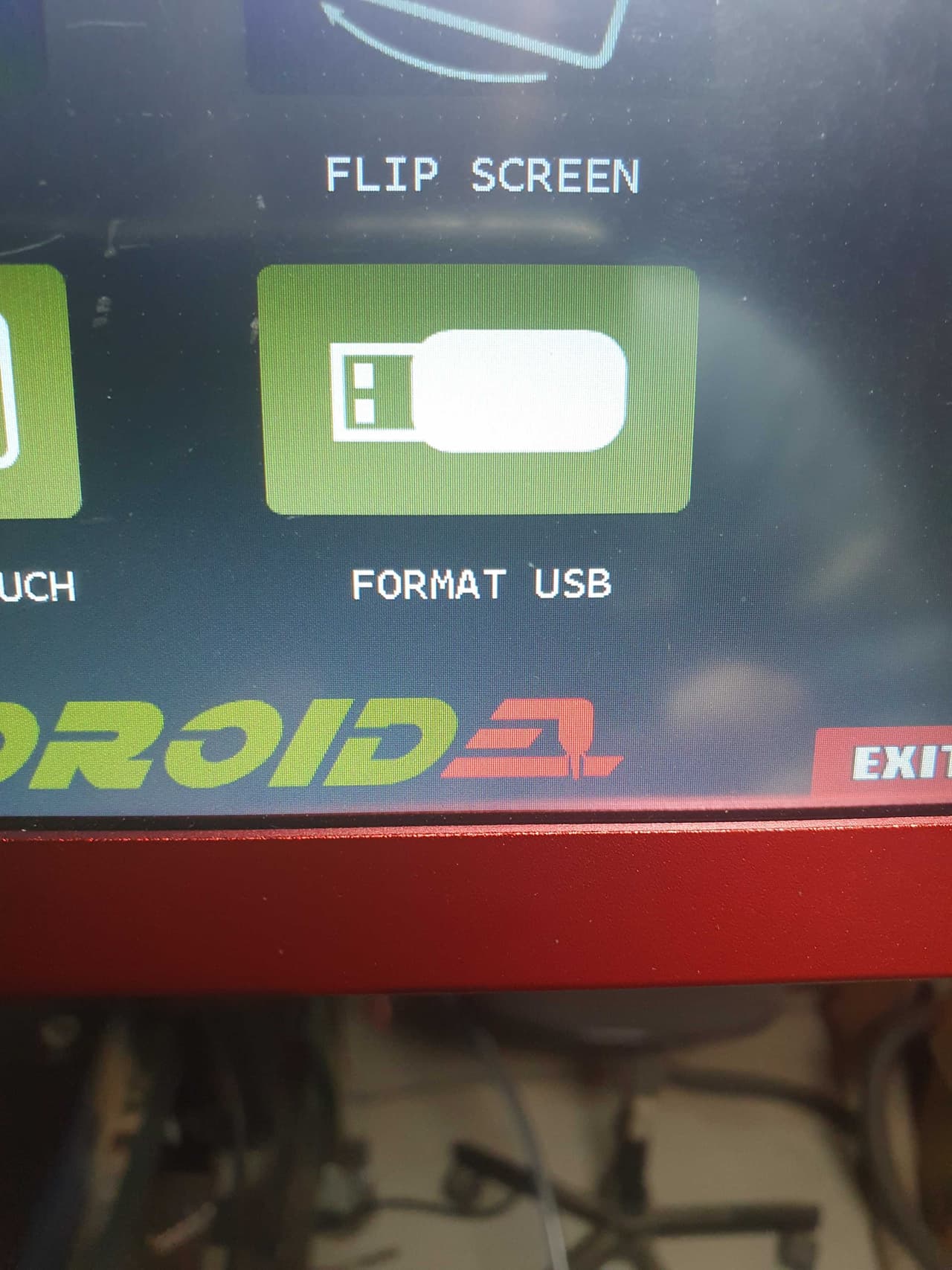

  1. Push settings screen
  2. Push touch screen
  3. Push USB format screen
  4. Push USB format 2 screen
  5. A USB error code 3 comes up
Could I please ask how to get this error code 3, away, and format the usb …… I am sure I am doing something wrong

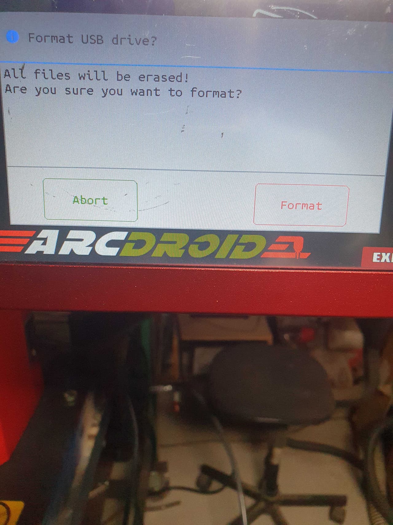

No, it is not just when formatting. please see the attached picture even if i plug the usb into the panel, it comes up with an error
if i then plug in the usb to the panel and the SD card into the machine, i get the same error

yes I have formatted both usb and SD card to FAT32 on my PC.
