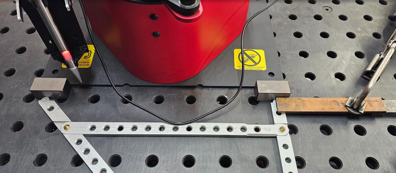

I just want to follow up for others, as I’ve had this same issue numerous times. It’s been mentioned elsewhere, but the ‘off-set’ of the triangle immediately fixed my previous issues with repeated calibration failures. @Andrew mentioned this, and @Amp_Mechanic_JB discusses the details here (video). A photo of my final successful attempt. I verified the 313 line test, and it was well within tolerance.
