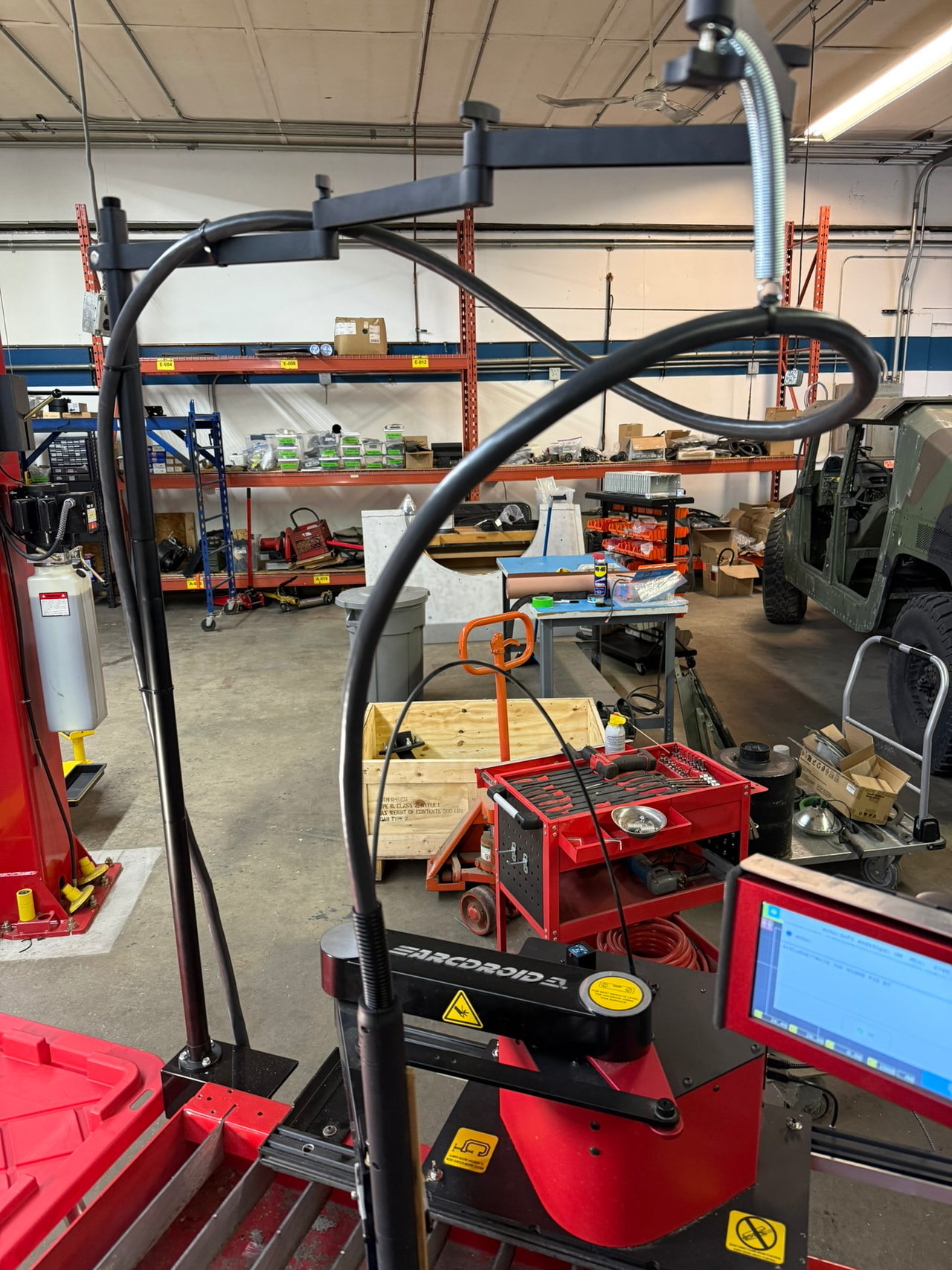

Can you send pictures of your machine set up maybe someone may see something?
yeah, here is a picture of my setup, however, the problem exists with the stylus too. It will run the exact same path with just the stylus hooked up so I don’t believe it has anything to do with my setup.
Put a swivel L bar across to help hold up your torch cable you have all the weight on your arm
well it does the same thing with just the stylus hooked up. I did have the torch cable supported above the machine at one point with a swivel but I was getting false probes.
Is the piece of material pushed tight against something? small strips like that will expand with heat and move if the push against something and give you a curved cut.

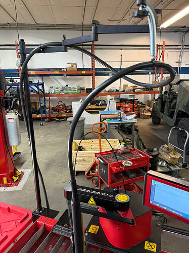

I found the same issue on long straight lines and traced it back to the resistance of the plasma cutter cord. If there is any weight applied to the cutting head, the arm motors are unable to compensate fully.
I built a system to eliminate the weight and resistance of the cord and it appears to be better.
See pic…
