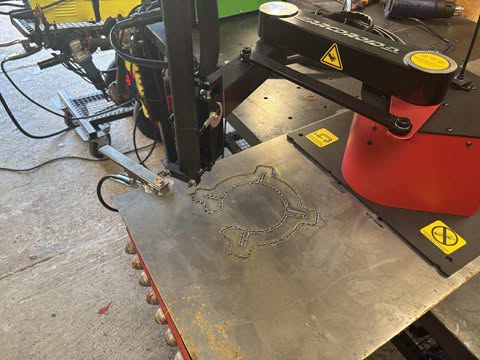

I’m very happy because I have a new arcdroid.
I’m making the first cut now. I want to cut out the TFT holder plan.
The torch goes down, makes a hole, but doesn’t make the cut. I think it makes the path wonderfully at a good height, but the torch doesn’t work. Maybe you can give me some advice.
feed 1000 clearZ 10,00 PierceZ 3 Cut Z1,7 Kerf 1,17 Prc Delay 0,1 Off Delay 1,00

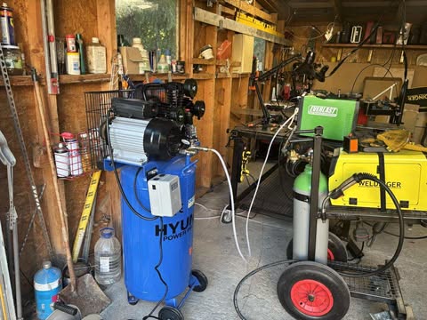

Everlast powerplasma 52I 40A air 61 Post Flow 60 CNC torch arcdroid factory cabel for everlast.
The situation is the same with other code and simple trace drawing.

Hi Andrew,
Thank you very much for your help. The situation seems to be improving after I set the auto restart function and cut back the length of the air hose. Now the torch turns on and off and the plasma cutter solenoid valve clicks. The compressor is a large 100l tank capacity machine with a Q=360 l/min volumetric flow. I regulated the air pressure to 6 bar.
