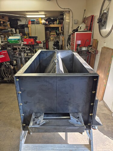

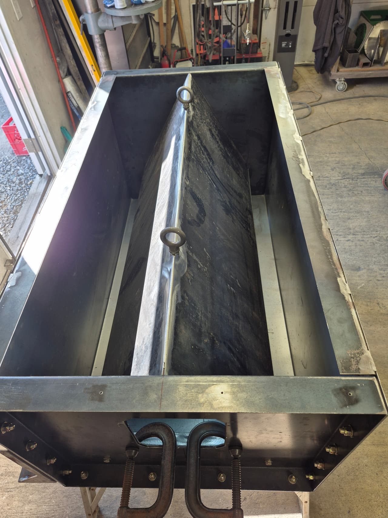

So I had some time this weekend to get the filter chamber almost finished.
I

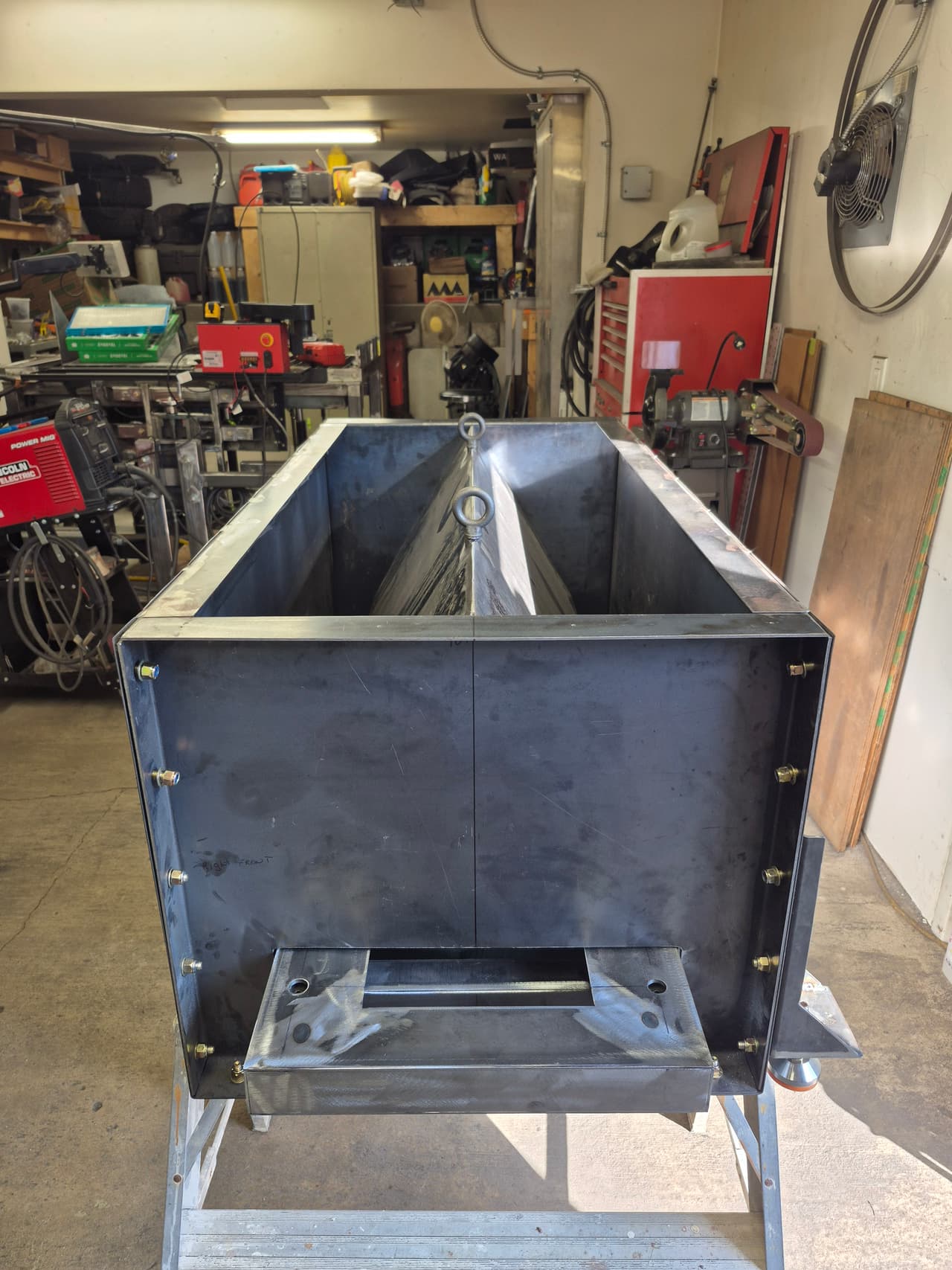

A little closer to having the downdraft cabinet done. Here is some pictures.
I’d say it is plenty rugged enough! Nice job.
Yes, it will aventually be cutting 1 inch plate. I am thinking long term projects. I am thinking of accessories to make my life easier in the future.
Thanks

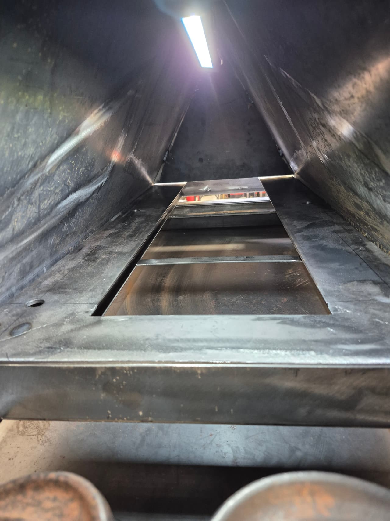

I modified a Vevor blower for my table build. I had to cut the ends off and reverse them opposite of what they had it set up for. My table works awesome great downdraft setup. Here is some pictures.
Wow, amazing setup can imagine how Busch time went into it
A little here and a little there. It helps compared to the old days. It makes projects that I do easier and faster. More to come.
