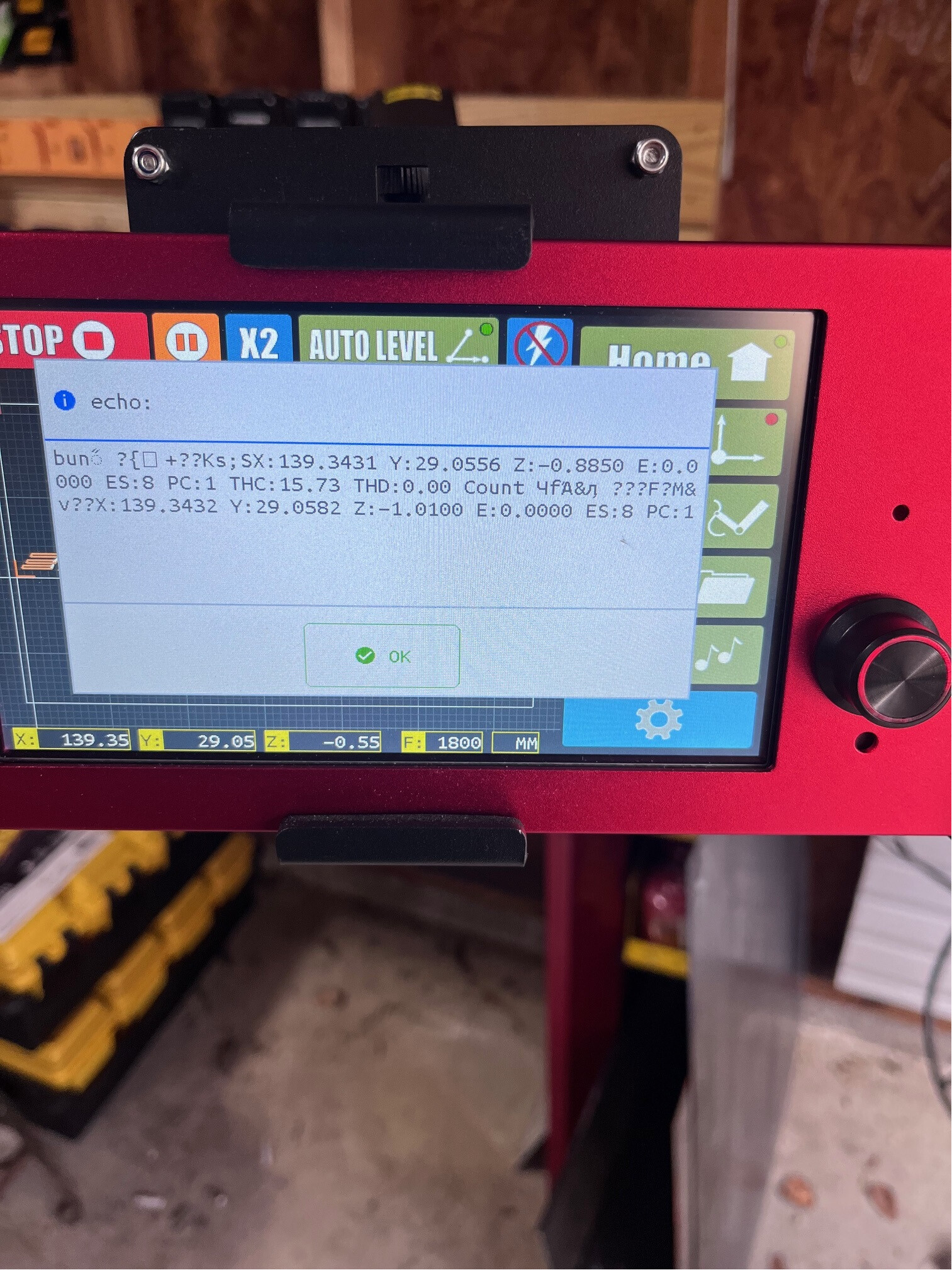

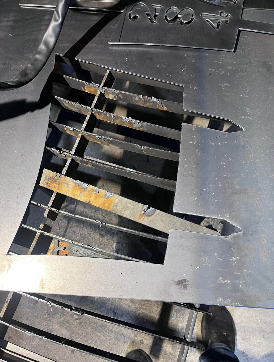

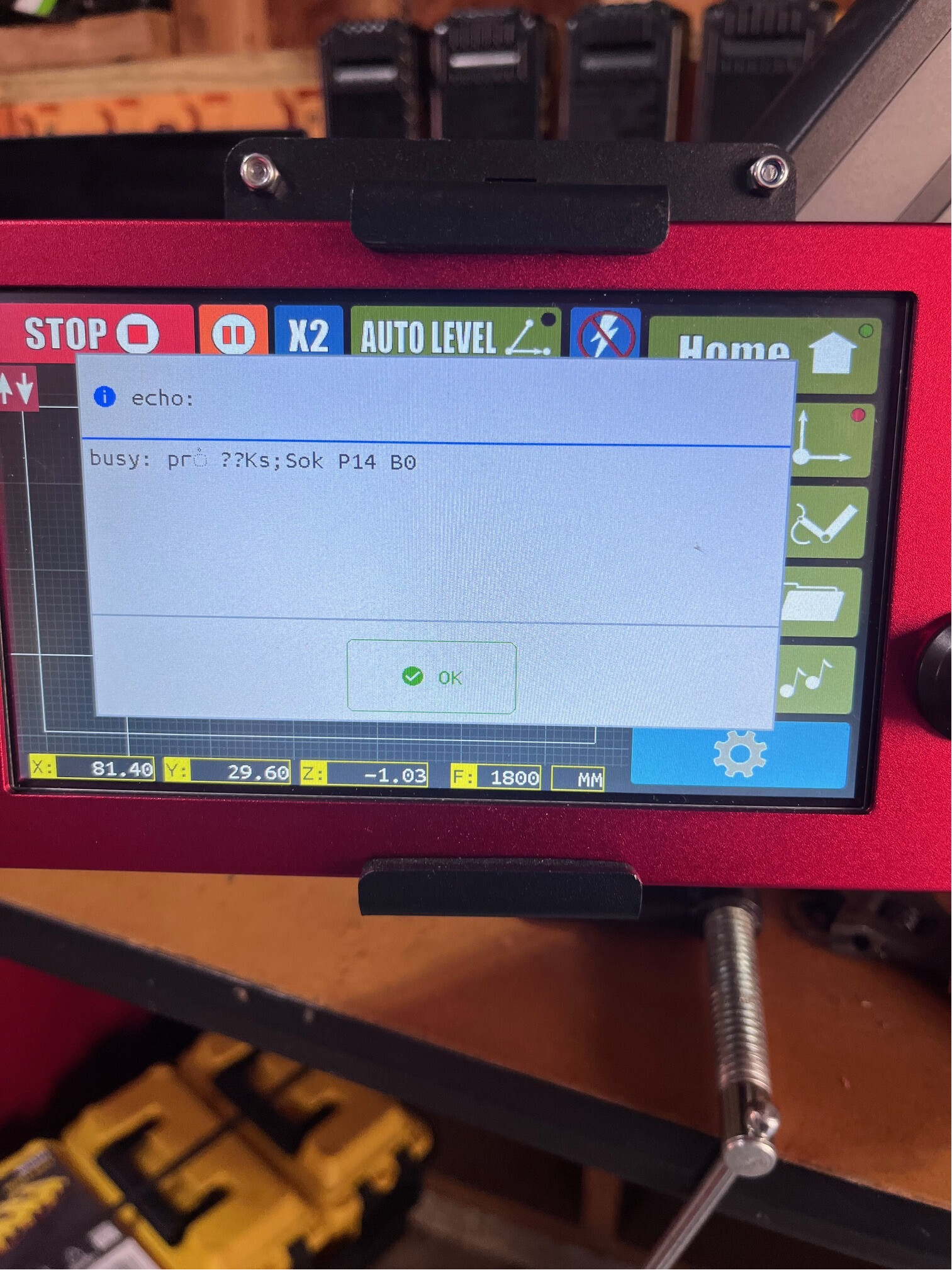

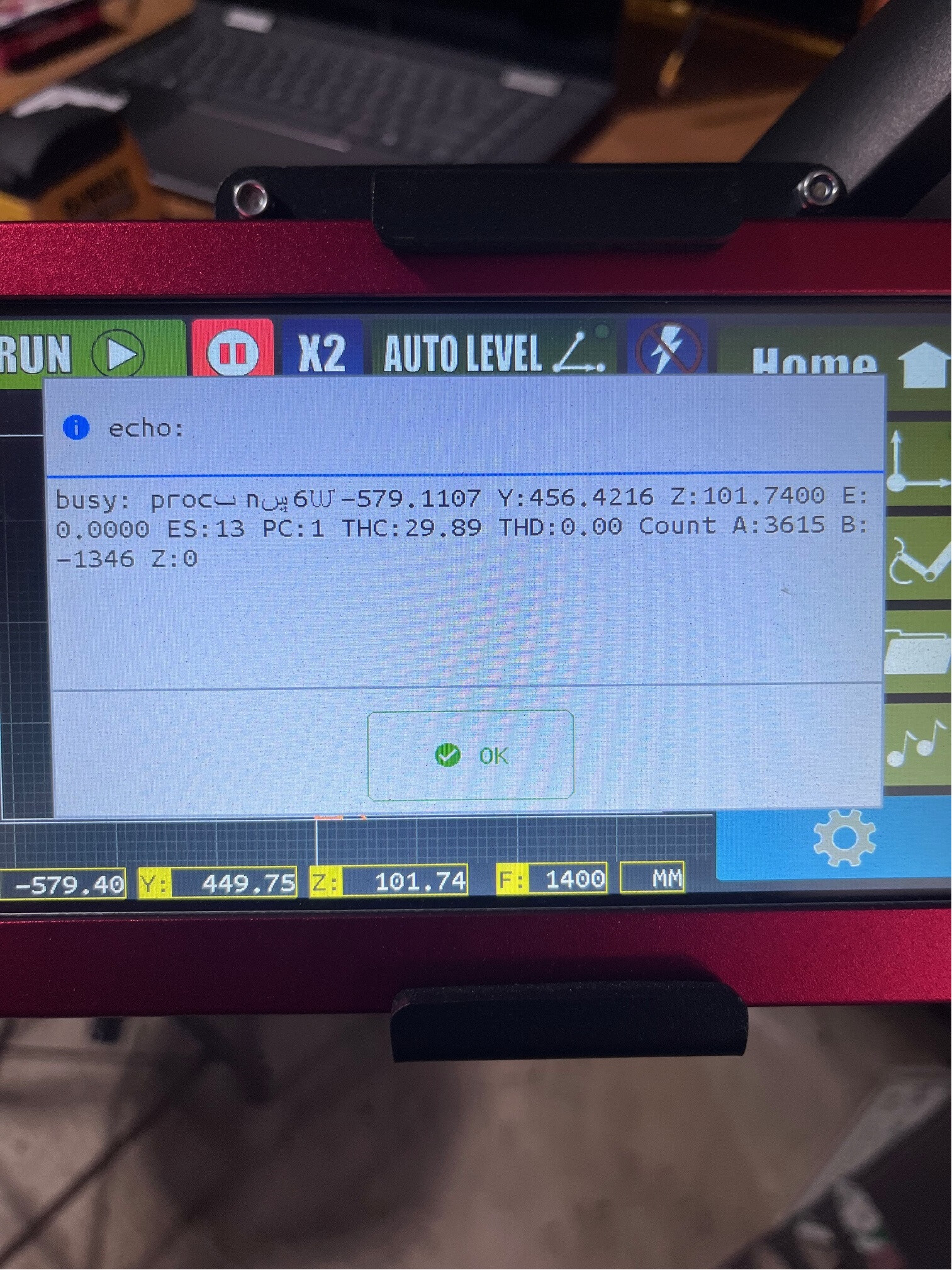

I recently purchased the arcdroid, x2, and flextable (along with pretty much everything else in the accessories section). After putting everything together and attaching my nonHF plasma cutter to it, I had issues with calibrating it (after unplugging from x2), and running even simple files downloaded from the shared files section here. I used a DXF of an address sign, consisting of a simple square with two stakes (along with an address and flamingo) and it would not perform more than a couple of cuts before an error would populate (see pictures - also an error saying “reset detected”—did not get a picture of that one). I ran the program about 20+ times to finally get it to finish, and when it did, the outside shape was drastically different than what was programmed and displayed on the UI.

This is 100% electromagnetic interference. What sort of plasma have you got?
Can we see a full view of your setup?
Tricks to reduce this.
  • remove the USB drive when cutting (some of them act as an antenna)
  • ensure all your cables are well separated
  • do not use a different/ longer comms cable for the screen
  • ground your table to shop ground (do not ground the silver encoder on the X2)

I appreciate the assistance, I probably should have updated this. It was a damaged Cat6 cable, I replaced it - no more errors.
