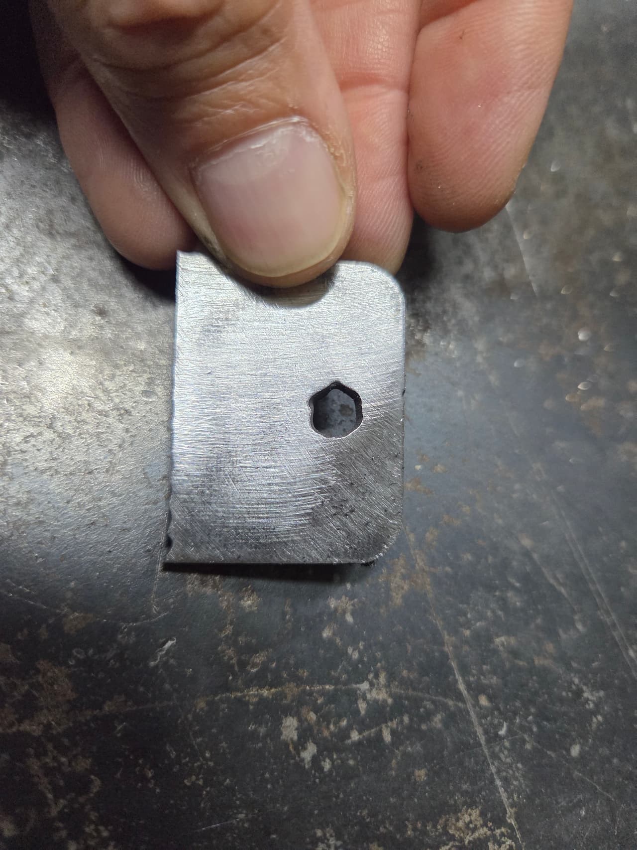

Here’s a top view of the pieces, wavy cuts are visible in the bottom right corner
It seems to happen to some of the holes too, resulting in very uneven holes

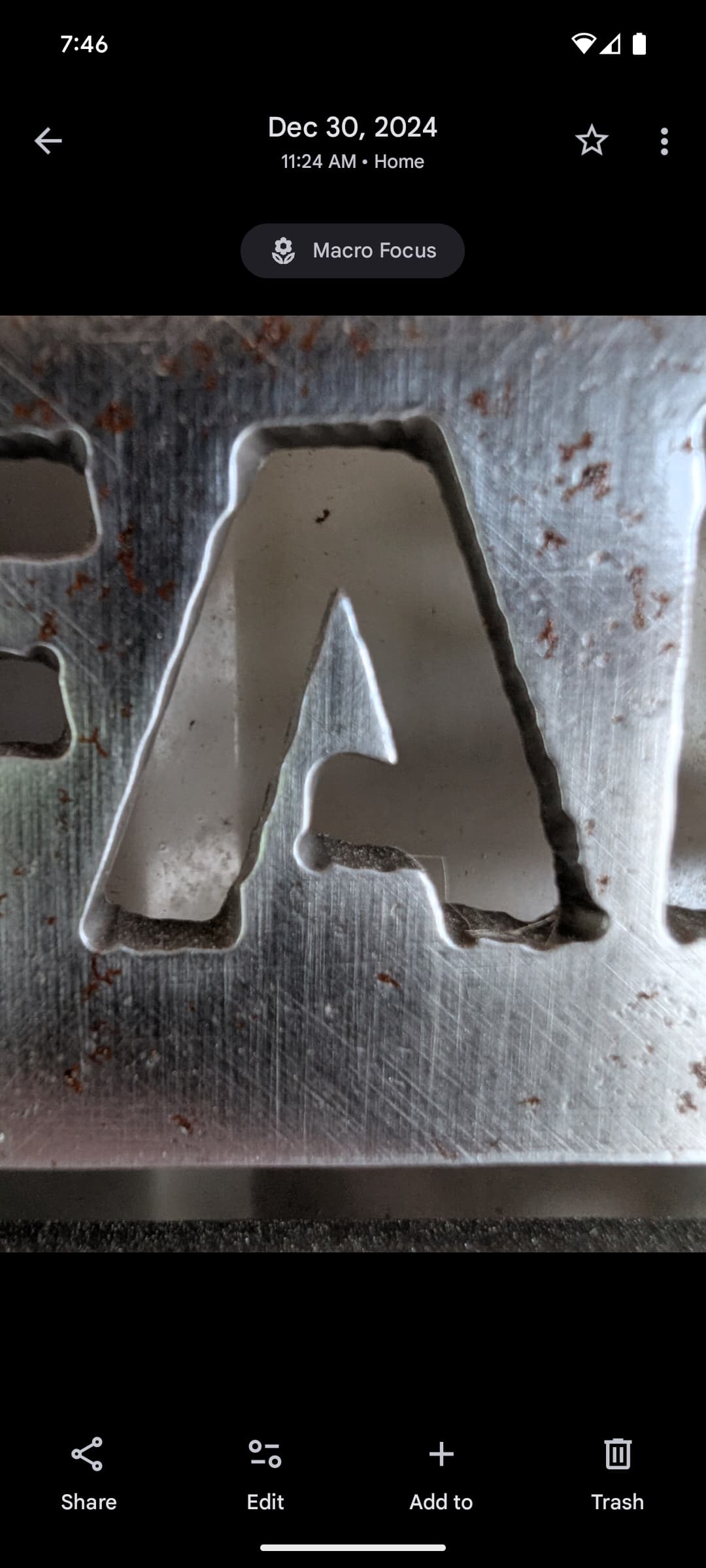

@Maximus86 I feel your pain….. or at least I used to. LOL. Check out this awesome video that addresses exactly what you are experiencing.
I used these settings and they made a world of difference. I attached a before and after shot of how the ocillations are dampened when adjusting the settings. (To give you perspective the “A” is about 1” tall). Give it a try and Good Luck! :+1:

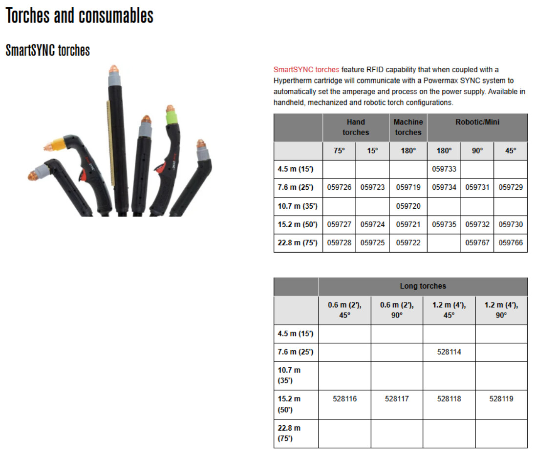

Where did you get that torch and how much was it!? Any info would be much appreciated. I want my handheld back for doing other work and a dedicated machine torch.
This is the “robotic/mini” torch. Hypertherm product #059733
Keep in mind this is a smartsync torch. I was not able to buy a non-smartsync machine any more. The consumables differ (and are a lot more expensive) than the older style.
