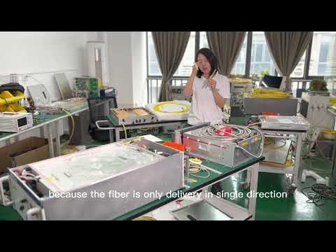

I saw another video saying that we need to be careful with reflective metals when piercing else there is risk for damaging the optics. I think for no matter what movement method, we should be careful about this.
All great points. Thanks for the tips and video. :+1:
