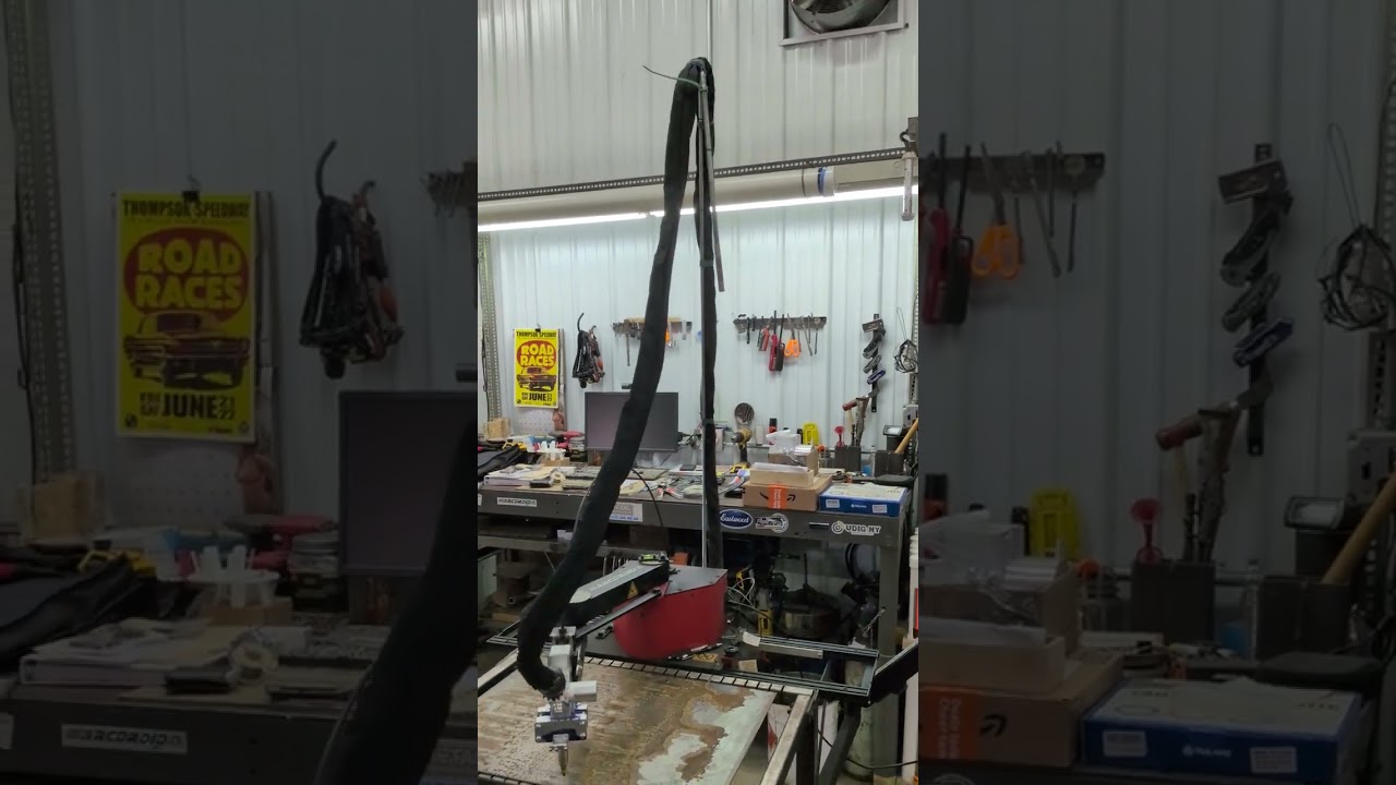

Getting close to burning with the laser. I’m not the first one to do it, but I see why it’s so attractive. The kerf is .2 mm!!
Attaching the mobility test. Check it out and let me know what you think. Thanks and good luck! :+1:

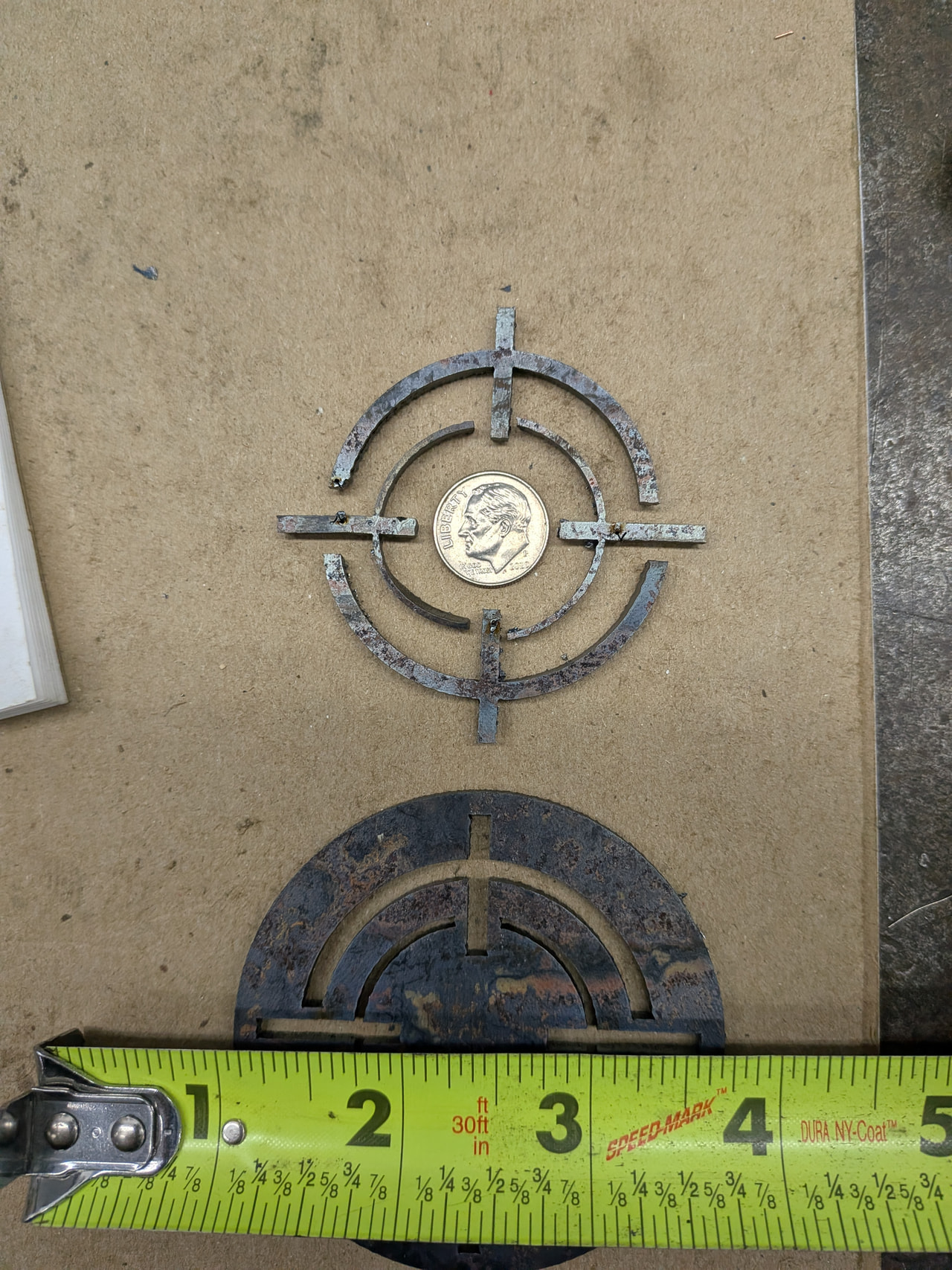

Here’s the first test cuts….
….AWESOME!

VERY NICE

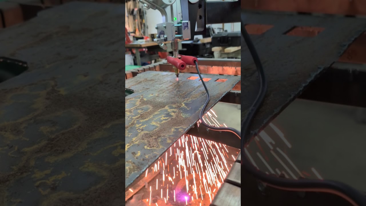

How thick of steel can you cut with that machine?
@Brad I attached a quick Short showing a manual cut on 1/2-in carbon steel. I wouldn’t recommend anything greater than quarter inch however, since the fine laser kerf has a tendency to bind up with dross. I don’t really have any need for fine detail work greater than a 1/4 inch anyways, so that’s when I use the plasma cutter. It just goes to show you how adaptable the ArcDroid really is. Thanks and keep burning! :+1:

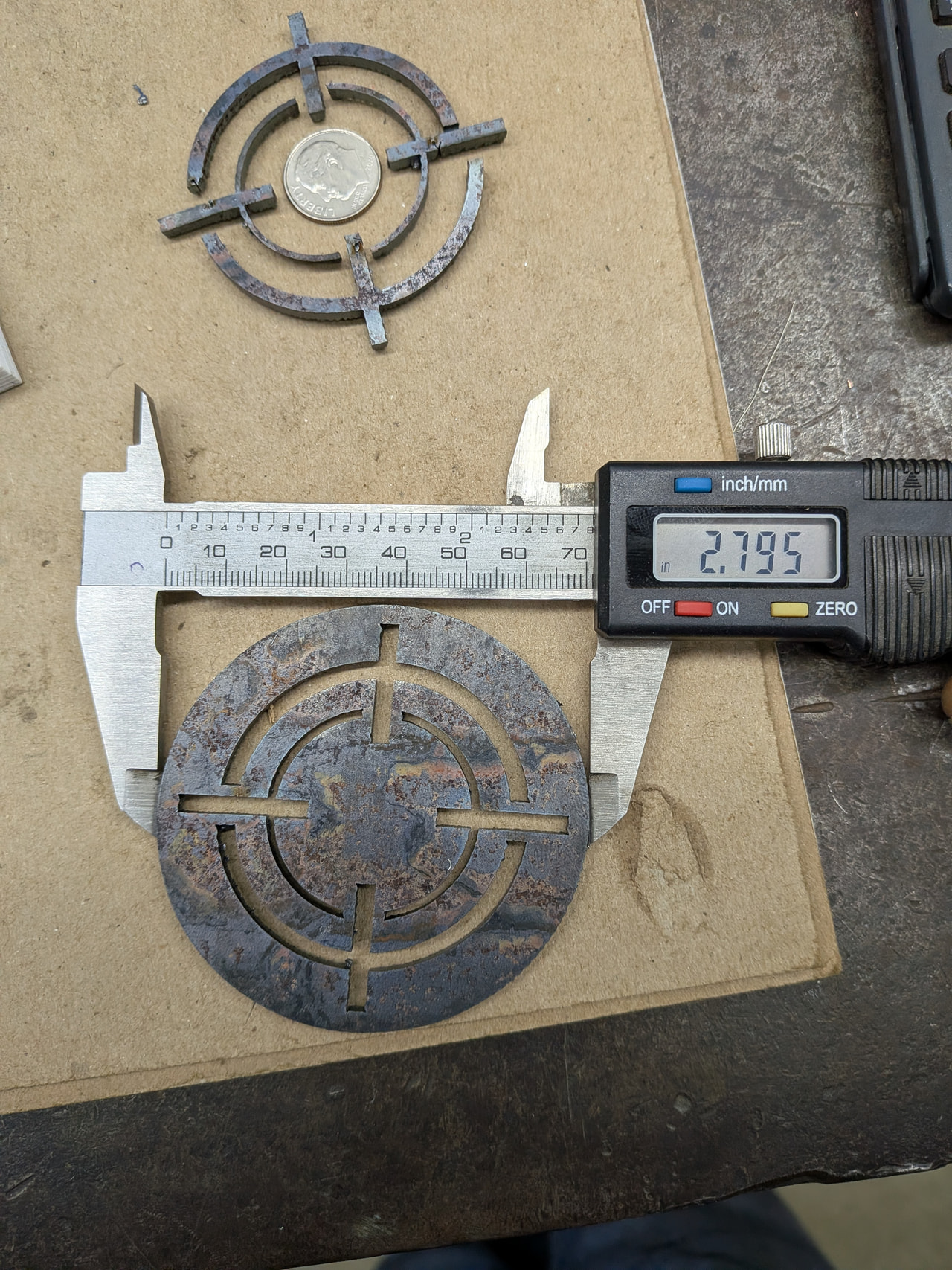

My original design was 11”. Used the ArcDroid to burn a quarter scale = 2.75” Came out with 2.795" = 45 thousandths off. Who do I trust ArcDroid or the Harbor Freight calipers? :joy:
