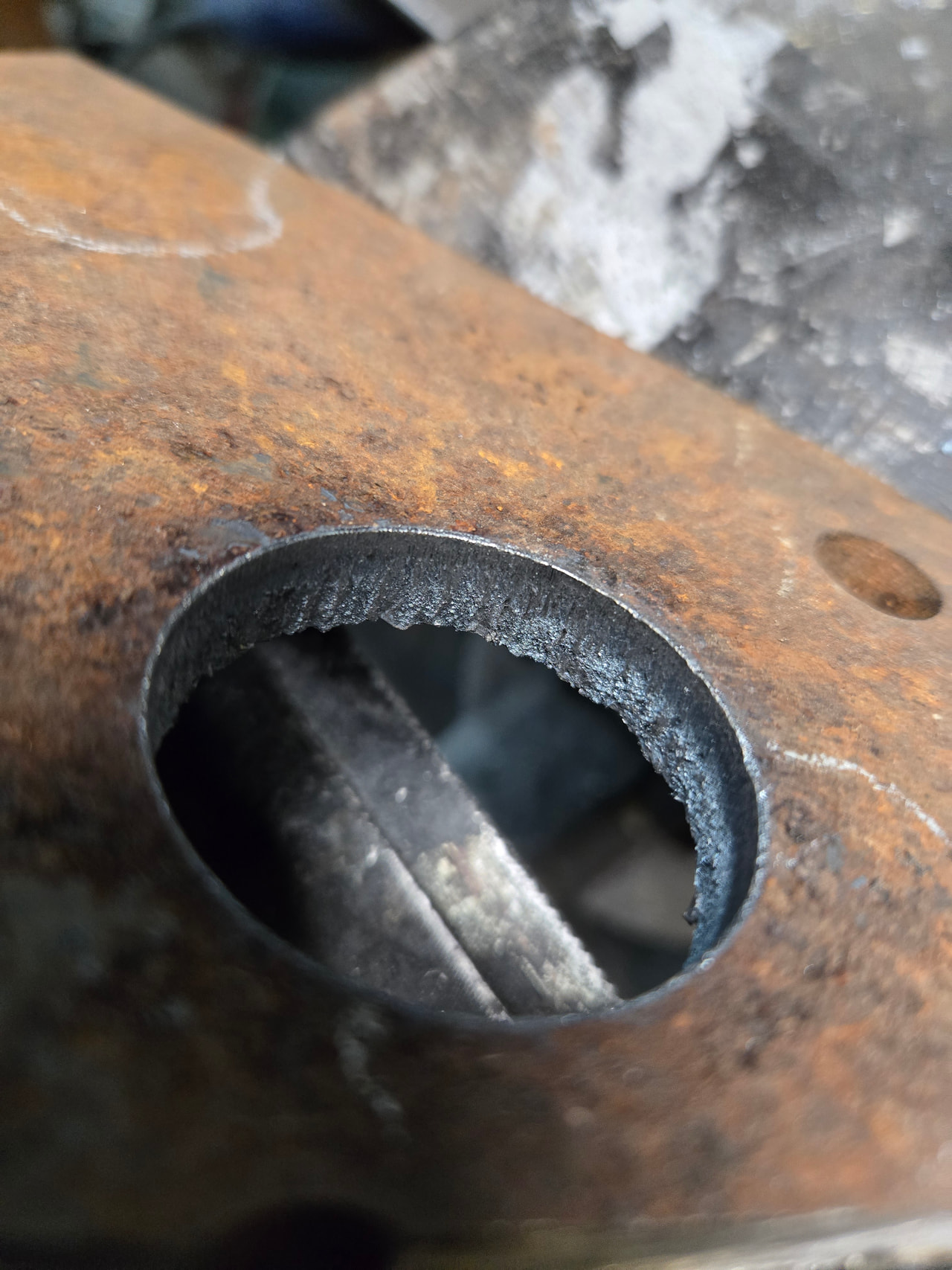

Hi, i was able to install my xtool laser on the acdroid by 3d print two small stand. The ardroid control the torch via the safety loop of the xtool.I cut 1/4 thick with dry shop air quite easy. Kerf is so small, piece have to be push out, but it easy. I cut 3/8 (Bottom pics) with same result.

That’s a super neat setup!
NICE!
Now I have to buy an Xtool too…..
