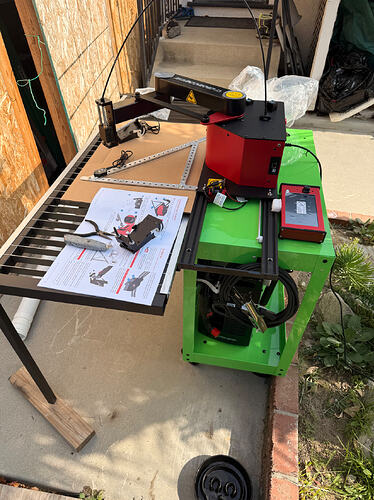

Here is my setup. Used a Harbor Freight cart and made removable cutting area so I can store easily.
