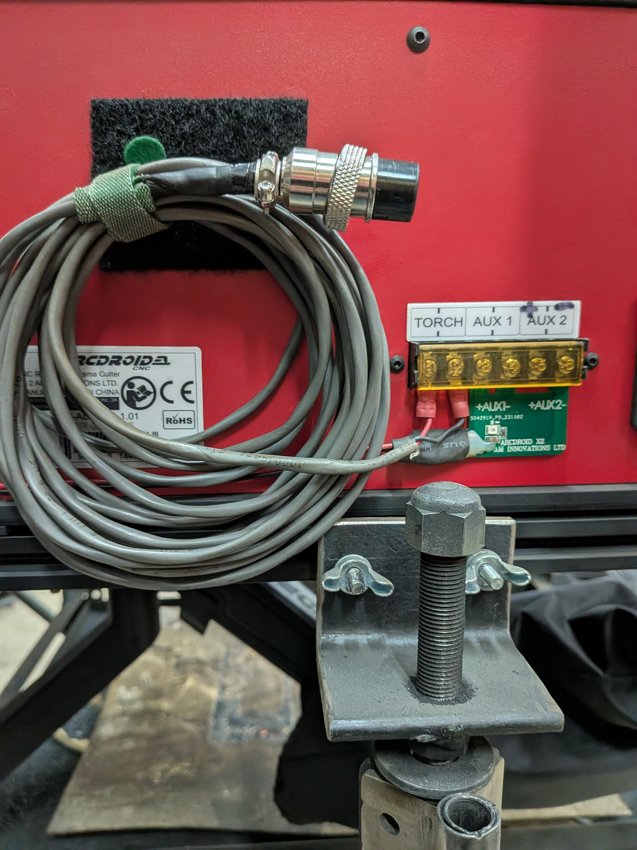

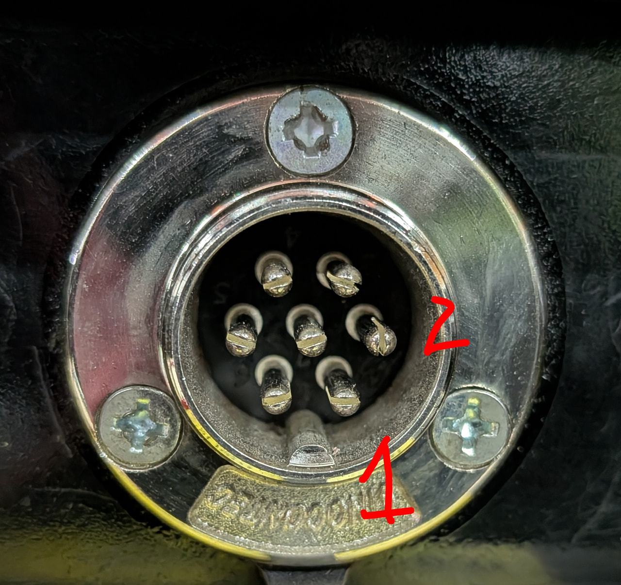

The ArcDroid arrived from Machinery House Sydney recently and after sourcing some of the recommended 18ga shielded wire I got it up and running. I didn’t want to open the case on my Everlast 3-in-1 so I soldered it onto the two pins inside the external Everlast connector per the picture below. Works a treat. Calibration was fairly painful with the shuttle jumping off the triangle, mostly towards the end of the third rail. Got there in the end with plenty of lessons for next time.

I saw the post with the pin splice on the machine. Sounds like yours may be different.. I did find male female five pin dins on eBay. Just curious if I could get a picture of your set up.. trying to check things out before purchase. I have the 256 SI purchased from 2018.
@Kgid185 Attaching a few pix of my torch trigger/controller connection to my Everlast 256Si. My machine is 8yrs old. I did not splice into the torch electrical connection. I ran a separate lead to the ArcDroid from the Everlast. I used 18 gauge shielded cable.
here’s the link to eBay where you can find the 5/8” 7 pin aviator connection…

This is 100% what I was looking for! Thank you. One question on the pilot arc. I don’t directly see what that goes into on your setup. Just so I don’t miss something. I purchased my 256 Si around 2018, I like the machine and didn’t want to have to buy another, yet.

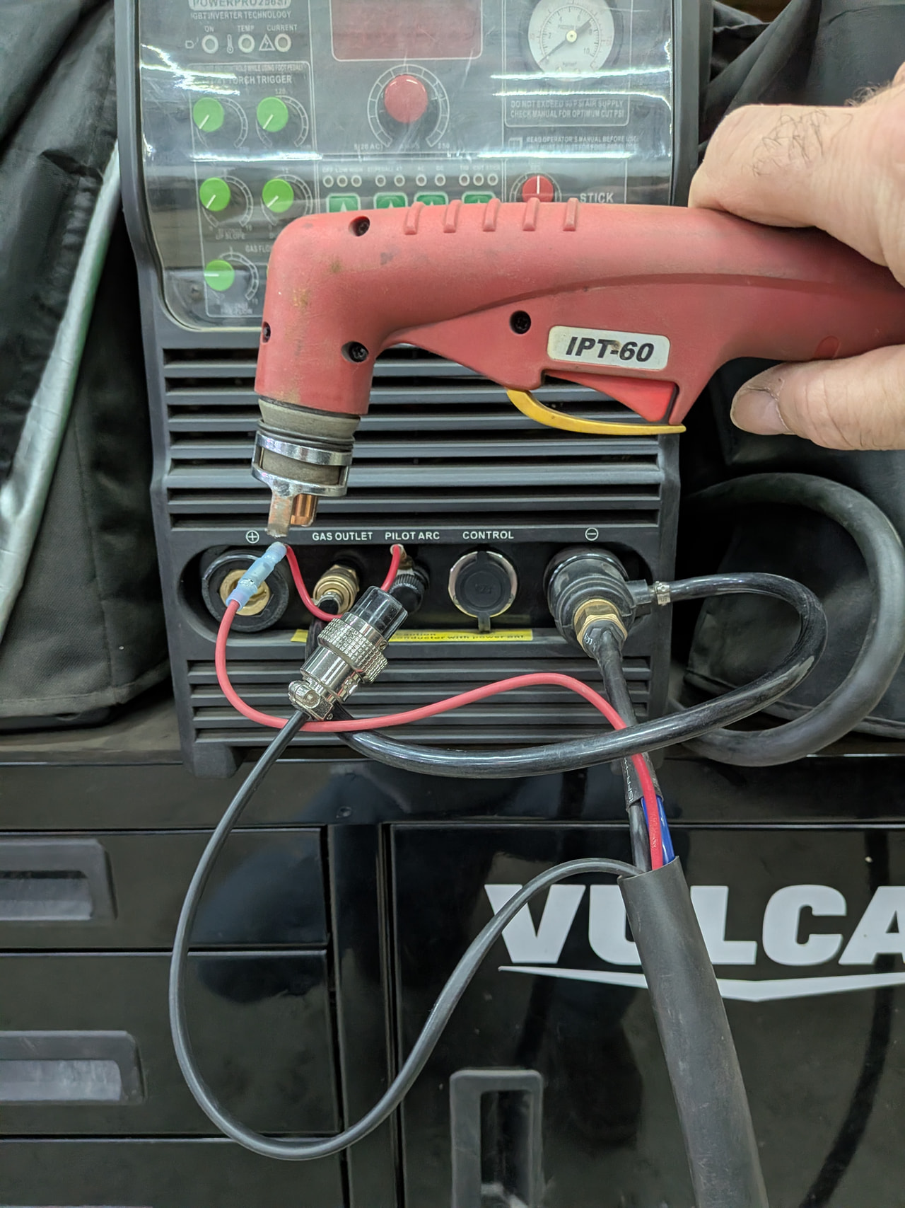

@Kgid185 I attached a pic of how I connect my standard torch. You’ll see the PILOT ARC comes fight from the torch itself. I use a quick connect rather than the original ring terminal that was once on the lead. I do not connect the torch’s 7 pin aviator connection to CONTROL on the plasma machine or anywhere. Instead, this is where the ArcDroid connection I previously pictured is tied in. Good Luck! :+1:
Thank you !! Between both pics I think I can get this set up.
@Kgid185 happy to help. Let me know if you run into any hangups. Good Luck! :+1:
